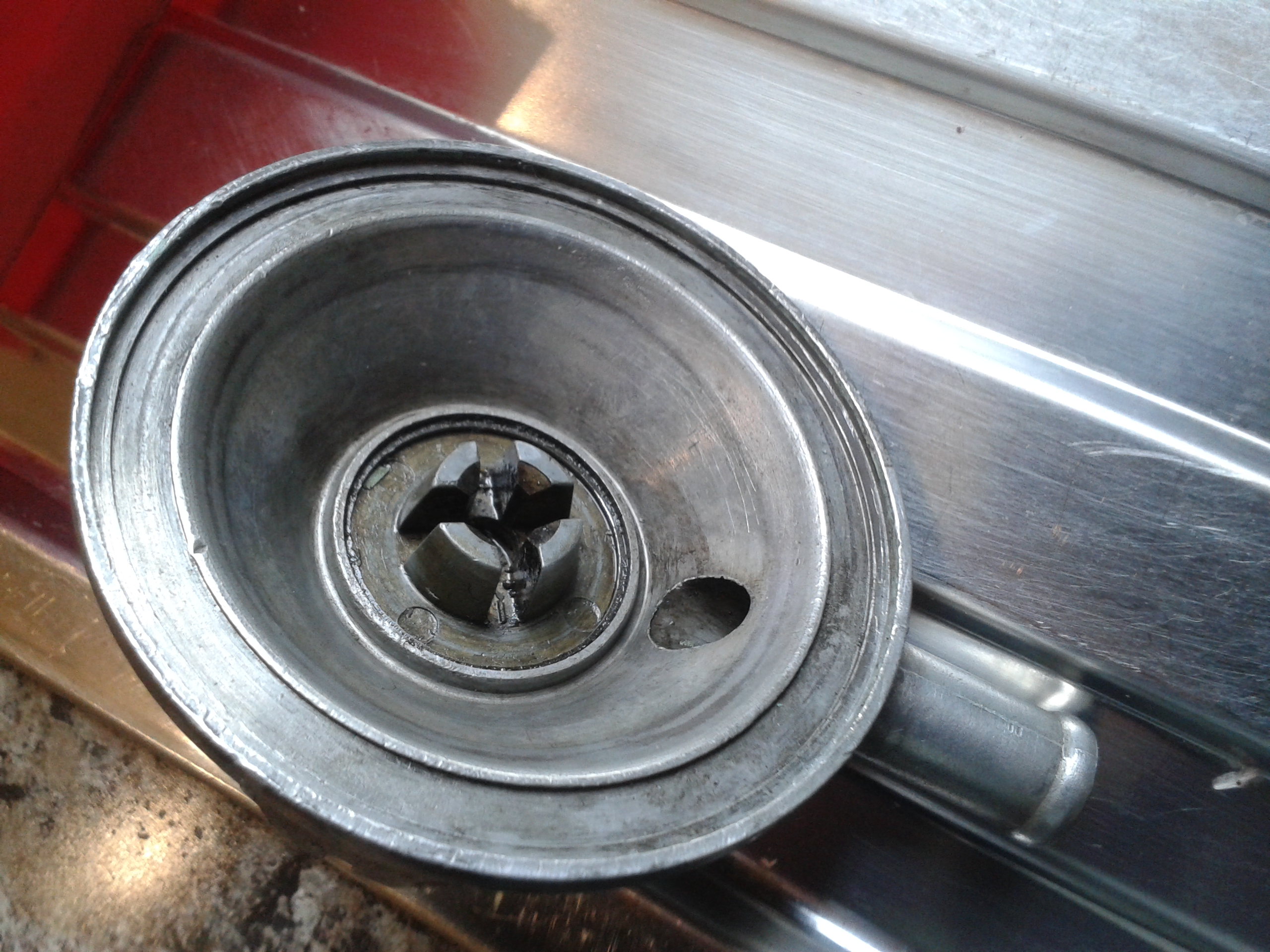

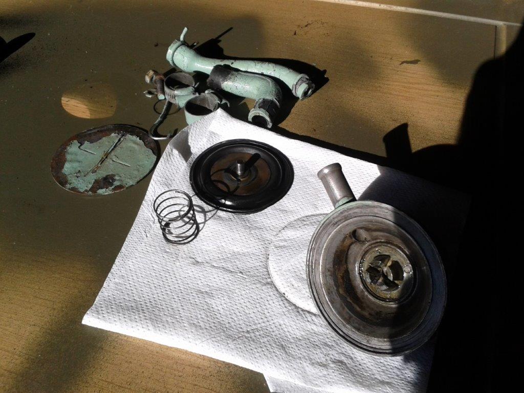

Post by Bob Fell » Mon Oct 25, 2021 8:24 am
Emission control valve servicing...often forgotten about but needs doing
Mine was pretty cruddy...
But cleaned up nicely:
and painted..,
Re: 19HF27
Post by Bob Fell » Mon Oct 25, 2021 8:29 am
Disc has gone in mild acid solution:
and come out like this..,
I wasn't going to paint it but the surface isn't good enough so looks like I'm going to have to.
