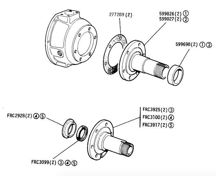

It will be quite easy to see once you pull it apart. Up to October 1980 the inner bearing was RTC3416 and the outer was RTC3426. They are clearly different sizes. After October 1980, they went over to the same bearing inner and outer (Its the same as Defender L316, Discovery, RR Classic etc. under part number RTC3429).
The earlier complete hub seal and bearing kit is RTC3534 and the later one is RTC3537
Worth noting that on earlier vehicles, the distance piece collar on the stub axle where the hub oil seal runs is replaceable (part number 599698). If you have the later stub axles and that seal seat is grooved or corroded, its machine a part of the stub axle. You have to replace the stub axle or you can save it with a Speedi-Sleeve (SKF).

Re: Wheel bearings for a 1982 LWT - imperial or metric ?
Post by Loulou » Wed Jul 14, 2021 6:40 pm
Hello,
As very well explained by Diffwhine below:
"Worth noting that on earlier vehicles, the distance piece collar on the stub axle where the hub oil seal runs is replaceable (part number 599698). If you have the later stub axles and that seal seat is grooved or corroded, its machine a part of the stub axle. You have to replace the stub axle or you can save it with a Speedi-Sleeve (SKF)."
Be very careful not to damage "599826-599827" when disassembling / destroying the old "599698".
You can then go back up quite easily by moderately heating the new "599698", in the oven in Madame's kitchen, and the "599826-599827" in the fridge, for example :mrgreen: ...
