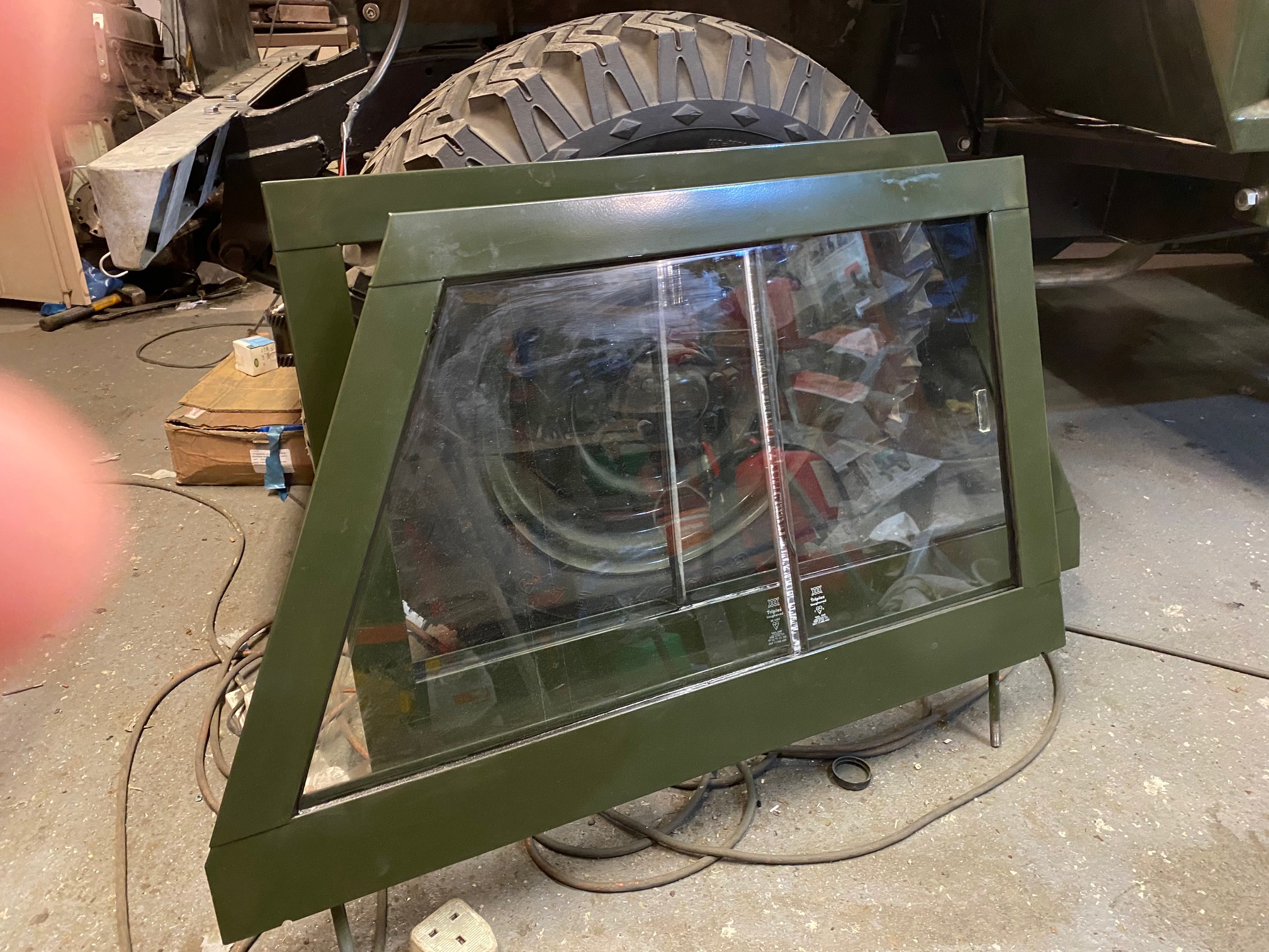

I haven't been out for the last couple of days - a new belt arrived for the compressor today and I haven't been out to fit that either. I did build one of the door tops over the weekend but haven't posted a picture of that yet.

Have built both door tops, visibly chipped the paint on one by dropping the old one on top of it!

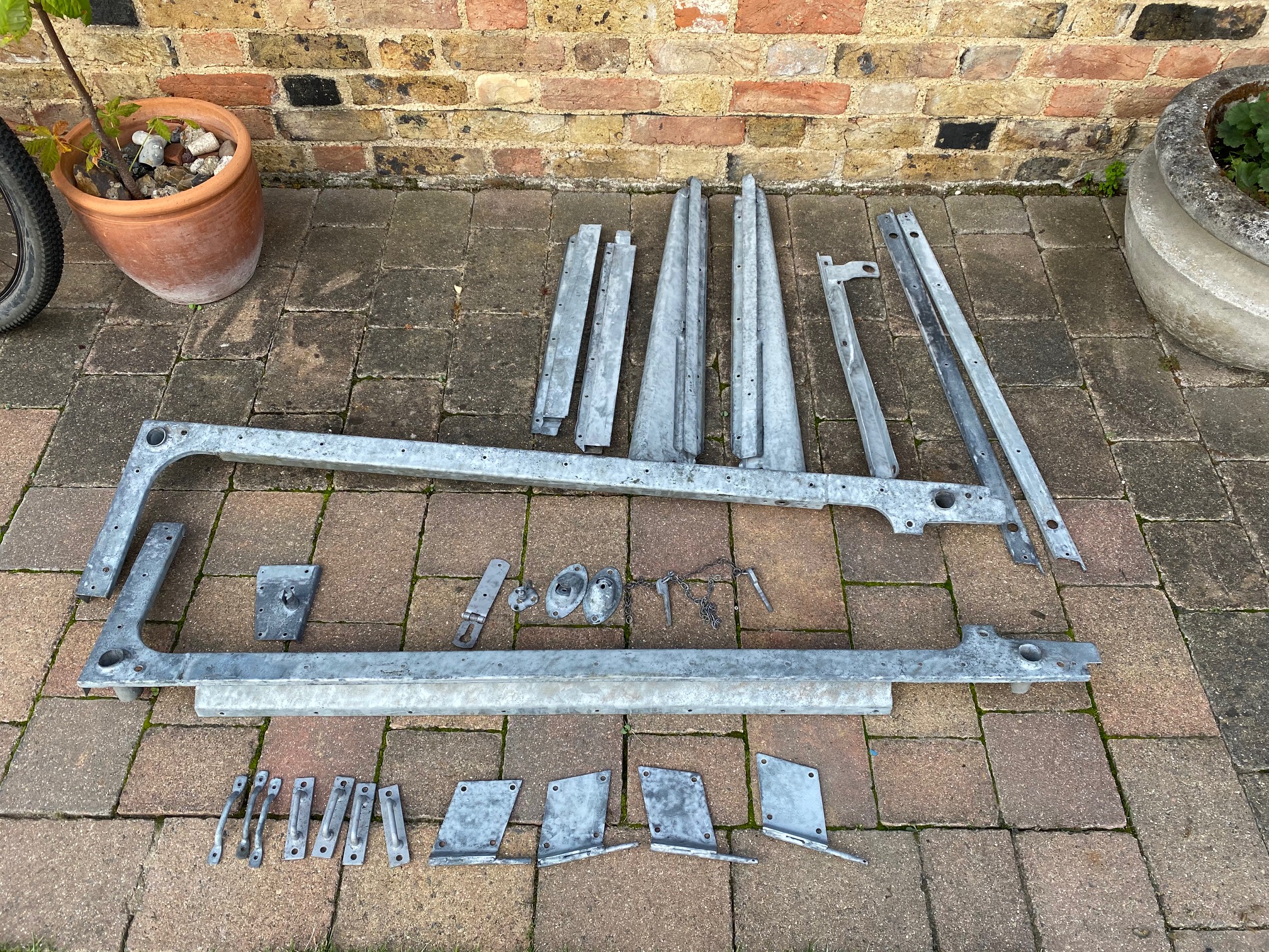

Post by landylees » Fri Aug 07, 2020 10:42 pm
I ended up buying a "high flow" kit for my compressor which effectively replaced the 8mm home with a 14mm main hose and a 10mm hose, sand blasting is now an altogether different experience - it wasn't the pressure or moisture, it was the low flow rate causing problems. Also welded up a few holes in the front bumperettes. Off to the galvanisers early next week.

Post by landylees » Tue Aug 18, 2020 11:20 pm
The parts for galvanising were collected a week ago. The company rang me up the next day to say they didn't do car parts any more as they were too fiddly. Luckily they had already picked them up and I had wired the smaller parts together - they agreed to do them if they could do them over 2 weeks.
