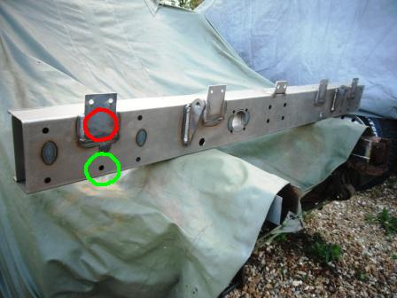

Most replacement rear crossmembers, whether they are plain, with extension, or on a 1/4 chassis, have the top holes for the lifting eye 'missing', as they are covered over by the tub mounting tabs.
Only the lower hole visible, no hole in tab.
They are however present on the inner face of the rear crossmember.
Both holes visible.
The strengthening plate to stop the crossmember deforming when the lifting eyes are in use is present inside the crossmember. Well it is on mine anyway. If you poke around inside the holes should find the inner strenghtening plate to the outer side of the holes. All that you should need to do is drill the holes through the tabs as I believe they are there behind the tab. It certainly didn't feel like I was drilling through double thickness steel on the last two I drilled, but I wasn't paying much attention. Whether you chance drilling the hole in the right place through from the inner hole, or line up a lifting eye on the outside is up to you. Personally I'd line up a lifting eye to be sure.
Both holes visible.
This was true of my Richards chassis - not that I got the hole positioned right due to my misleading series earlier short lifting eye and my stupid impatience. Neil is right - Get hold of a correct lifting eye (4.5” long) and use it as a template.

Same "worries" with my chassis (Richards chassis).
The upper hole is visible inside the cross member, but hidden on the outside by the grab lug.
I will temporarily fix the lifting ring with the lower screw and this ring will be used as a template to start drilling the upper hole. Final drilling alternating from the back and from the front.

Sorry to not reply sooner. You are all right. It's amazing what you don't notice when it is staring you in the face. The bottom hole is there and there is a another on the rear side of the bumper. So all good to go. I have the lifting eyes so will bolt these in place and use as my drilling guide.
