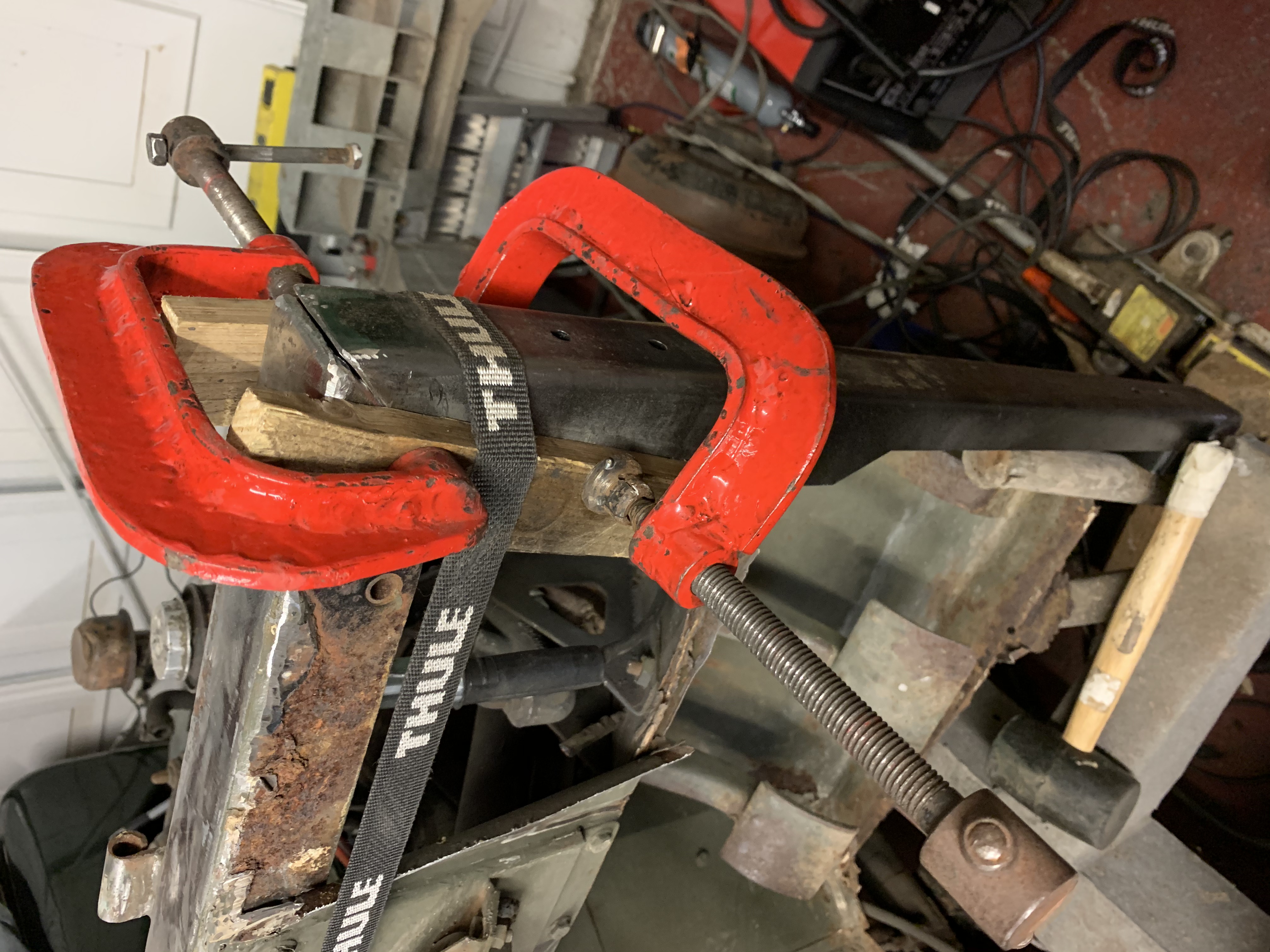

Bit of a lull in 2a towers, few domestic things that needed attention .. so today got stuck into the Driver's side A Pillar. Buoyed up after working on Passenger side - how hard was this going to be? Got stuck in with the saw and the grinder and extracted the old pillar. No problem. But as i removed the bolt from the chassis i spied the bolt end. That bolt was fitted when the chassis was renewed at the end of 2008, and for the last 6 years has been sitting in a dry garage. That was a bit of a surprise to me, it had rotted back to the nut. Anyway got it all lined up and clamped ready to weld. Life's a Gas - The Point.

Dougie, re: the gas and the welding of thin parts like the fascia...a game changer for me was gasless (flux cored) welding wire, and perhaps more importantly - a drop down from 0.9 to 0.8mm wire. No blow throughs and no worries about gas escaping. You will have a bit more grinding / dressing of the weld with your power tool of choice, but it does work.

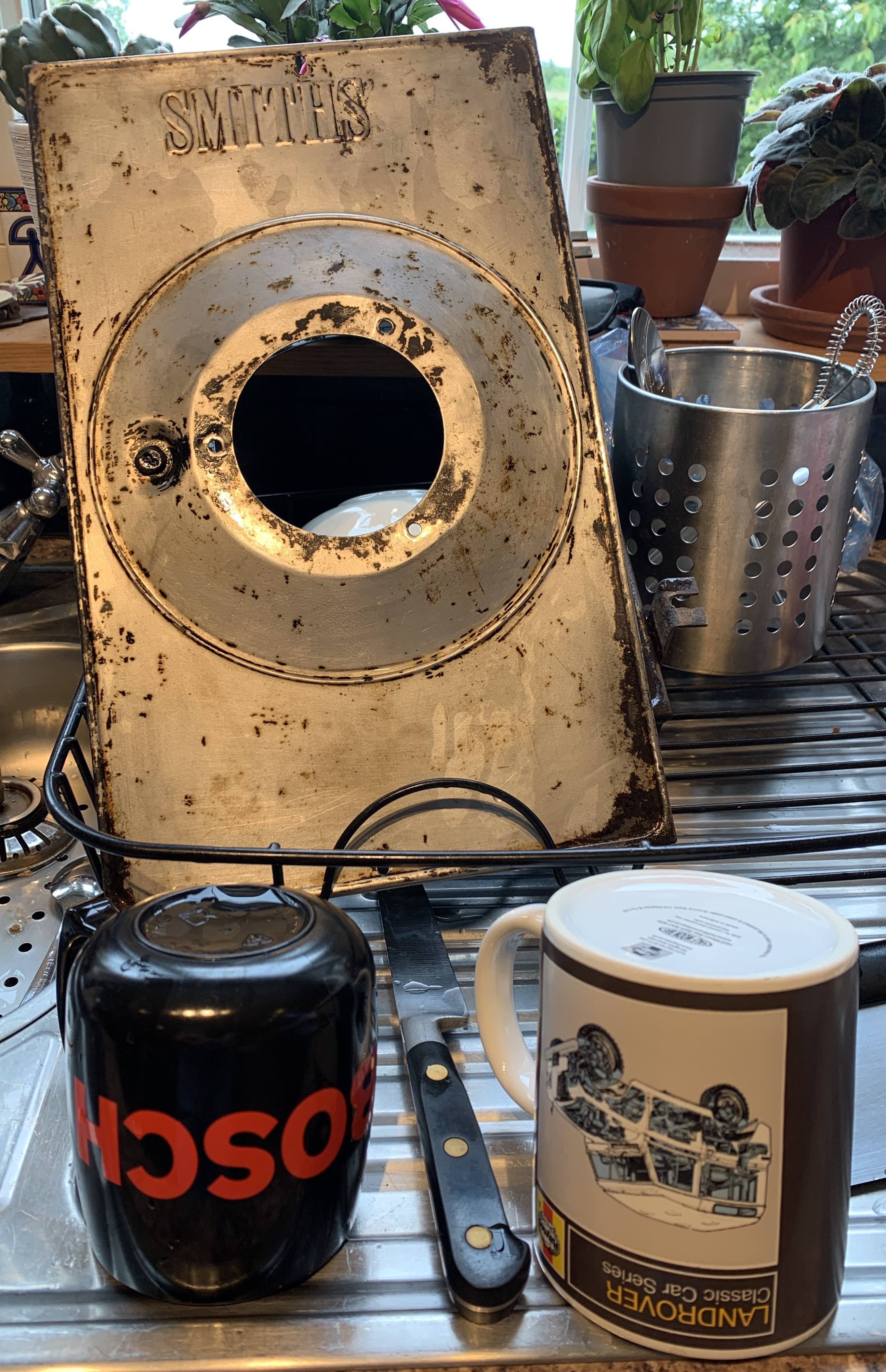

Been a bit side tracked on the other 88" 2a, need to get it on the road again before I get the go-ahead to get back to work so i can settle the credit card bill... Mind you, i seem to be spending a lot of time fixing an other guys fixing. - so am now working on the principle of - "The Next Time The Other Guy Will Be Me", I find that works for me!
My "Special Projects Manager" has meanwhile got stuck into the Smiths Heater she oft' complained about in the deepest of Scottish winters - especially in the July of the year. Of course the right angle bend on the feed hose wouldn't have helped.
I am convinced i saw a very detailed post on this forum, re the rebuild of a flat heater. I have searched the forum and have not come up with the article i remembered, and now my Clicky-Mouse-Finger is getting sore from searching page after page.
I've seen the Bob Fell post "Re Smiths 24v heater rebuild" of April 11 '18. Does anybody know of an other post? I just want to check a couple of details from photos on washer/spacer positions etc as Special Projects is of the opinion that its not the first time this heater has been opened.
Thanks in anticipation, Dougie

Re: Series 2a 35 FG 55
Hi Dougie,
There's a few heater pics on this page and the next in my rebuild thread, don't know if they'll be of any use to you though?
https://forum.militarylightweight.co.uk ... start=1270
