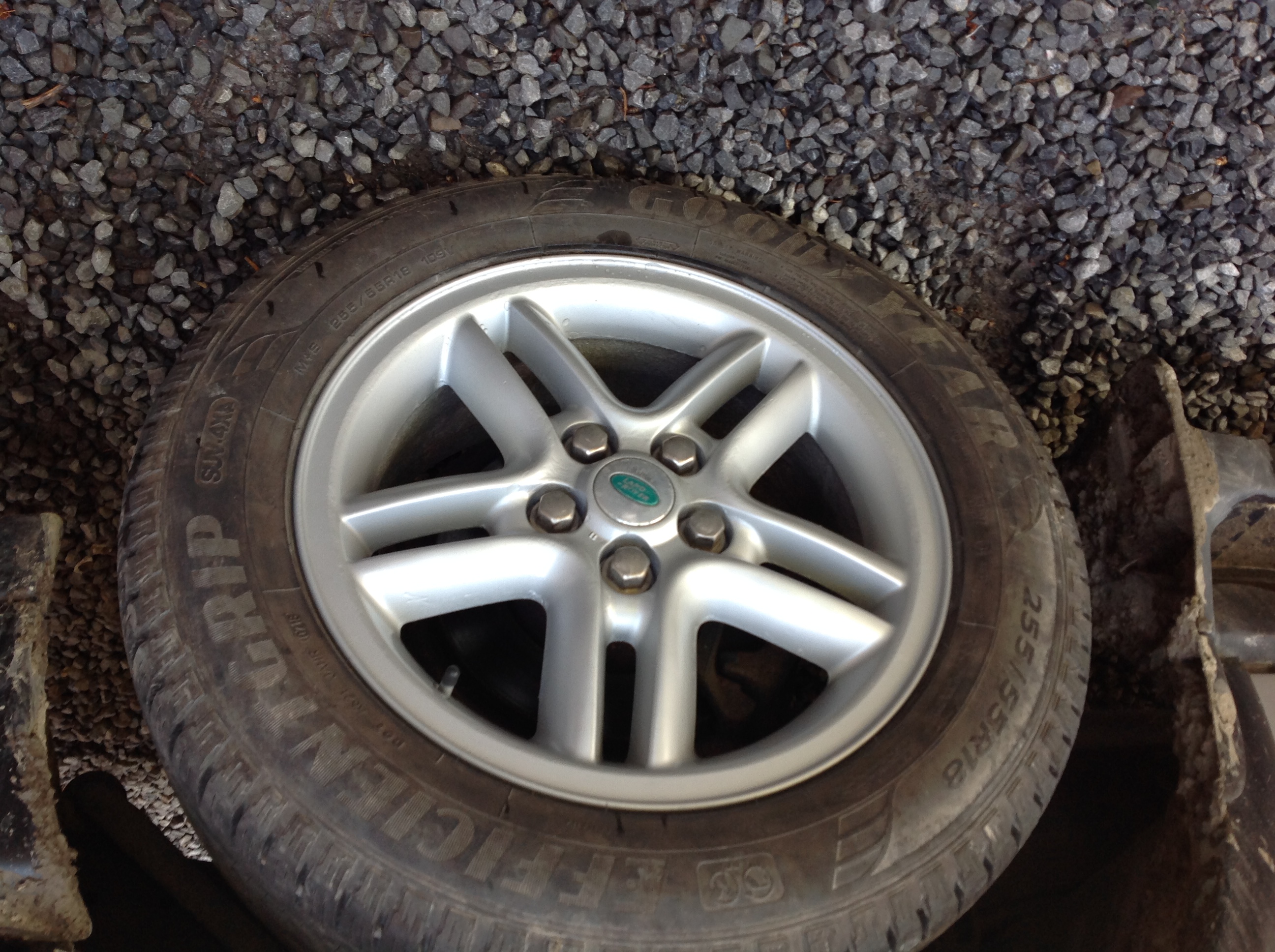

So, I finally got round to sorting out the wheels. I had them all off in turn, rubbed them down and resprayed and lacquered them all. I even got a small brush and repainted the Land Rover logos in the wheel centres. I must say, I'm pleased with the result. At the same time, I found a spare wheel cover on eBay for £20 which simply needed a few coats of semi-matt black paint and that has also been fitted.
The car is rather grubby as I went to walk the dog at the dam today and there is a hydro electric scheme going on there so the road was filthy with large puddles. But, this is how the front bumper looks now (with working headlamp washers as well!) I'm quite pleased with how it looks now, better than the scrubbed silver. I also cleaned the haze off the headlamps and sealed them to stop them misting up.

The wheels have come up nicely. 8-) I'd best think about cleaning up the ones on the 90 as I ordered some new tyres for it on Friday. (Ouch! They don't get any cheaper do they?)
