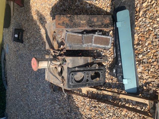

Today I managed to get the electronic ignition fitted and started to strip off some ancils in prep for a re-paint before work.

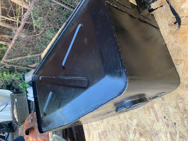

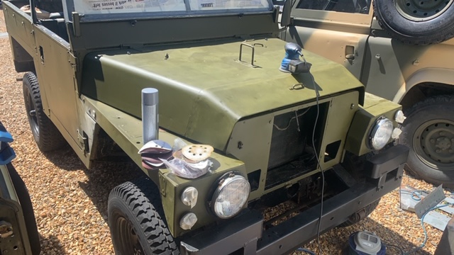

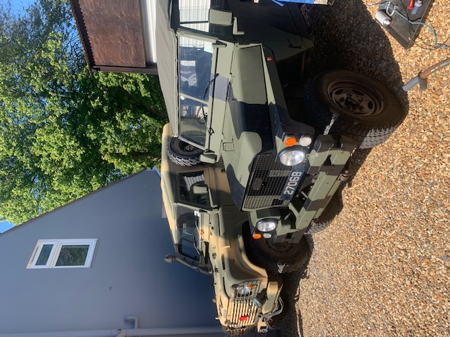

Well with a few afternoons and mornings off (got to love Shift work) I've managed to get a fair bit done on the wagon, the horrible OD green is now 95% gone and the NATO green/Black is on :D X!
sourced a few parts including fuel tanks as mine only has one fitted at the moment so I've been able to clean and de rust it before giving it the first of two coats of paint and a final topping of Dinitrol.

Post by Mash » Sun May 31, 2020 5:54 pm
Paint job:

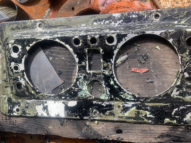

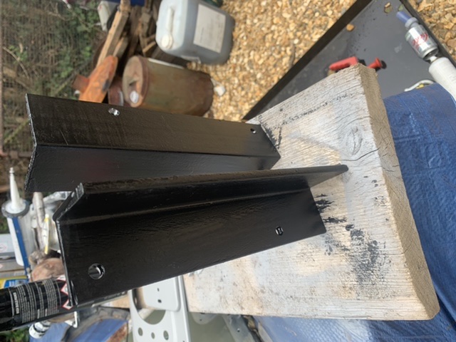

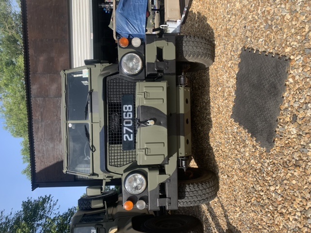

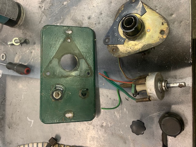

Few Random ones:

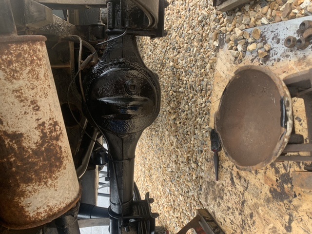

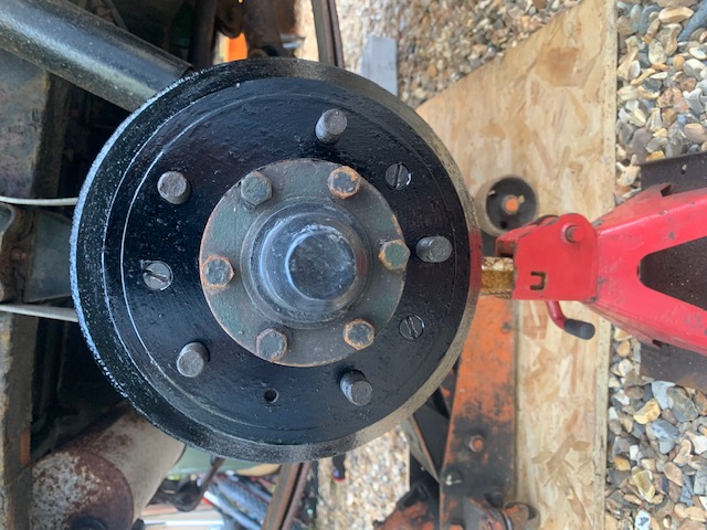

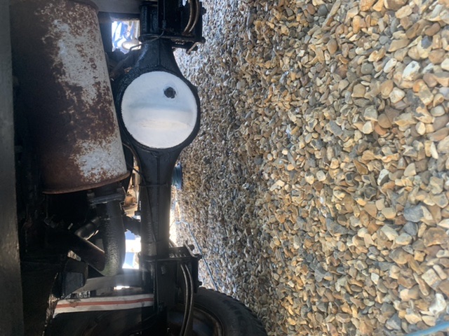

Ok me and the mrs have been flat out on any time off to get her ready for the first military vehicle run and Land Rover run since the lockdown has eased off.
Rear half of the chassis and rear axle has been wire wheeled and repaint by her whilst I’ve been pottering around on various other bits, the front half is now underway and should be sorted by tomorrow.

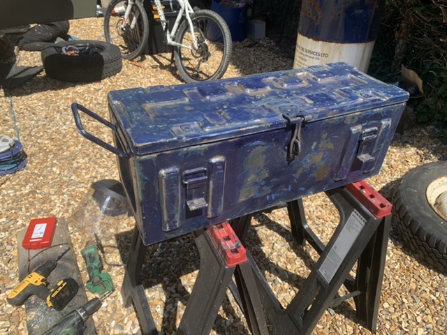

Also picked up this ammo tin for some additional secure storage.
